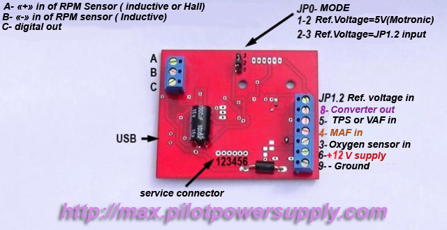

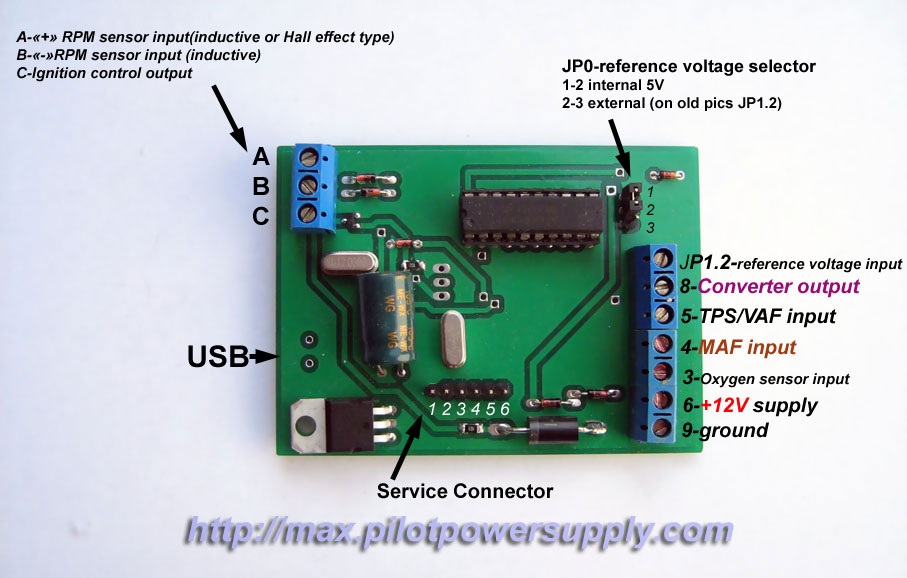

4. When de-energized the converter closes with screwdriver pins 5 and 6 on the service connector. ( or you can use some wire jumper for this)
Вложение 2001
Вложение 2002
5. When 5 and 6 contacts of the service connector are closed together, switch on the ignition or power supply of the converter.
