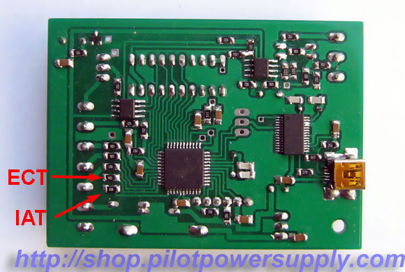

IAT and ECT connection
You will need to solder some wires

Rohan 15.06.2016 18:52
That's excellent news with regards to inlet air temperature IAT, but what is ECT engine coolant temperature?
What is the wiring for this? Sensor and common?
Pin 02.07.2016 12:50
Sorry for delay with answer.
ECT is engine coolant temperature sensor.
Both of IAT and ECT sensors has 2 terminals - one of them ground(common), and other is signal to ecu( inside ECU there is some resistance from internal 5V ref to this wire).
Wiring is very simple- all you need is to connect corresponding input of the converter in parallel with signal wire of this sensors.
IAT and ECT shoul be conneced to ECU to get ref voltage, otherwise they will not work.
