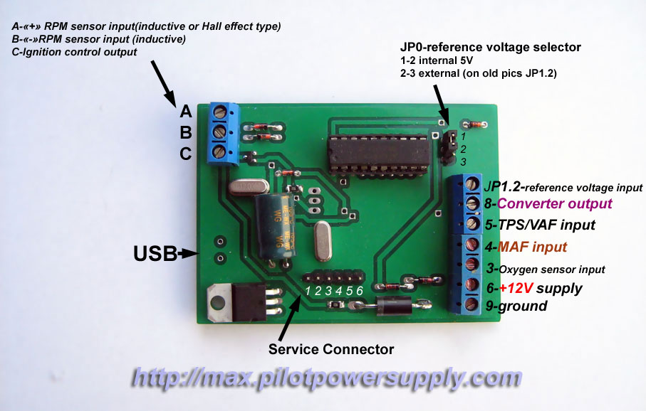

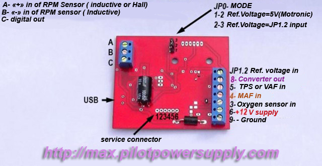

4. When de-energized the converter closes with screwdriver pins 5 and 6 on the service connector. ( or you can use some wire jumper for this)
