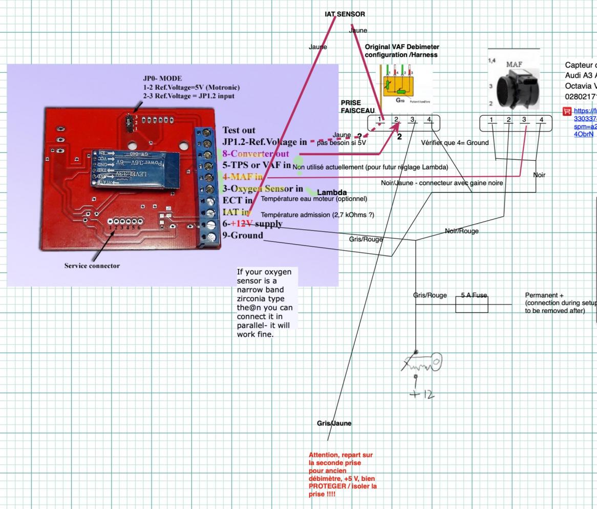

I have made a draft of the wiring plan which you can find here if needed for verification and comments => https://www.dropbox.com/s/wqn86sofvr...p1%29.pdf?dl=0
This is wrong.
1. You should find the signal ground of genuine airflowmeter and connect ground of the converter and new airflowmeter to that wire, otherwise you will get a lot of noise in signals.
2. During tuning process connect supply of the converter and new airflowmter directly to the battery + via a 5A fuse - this will make tuning process very simple, beacuse the software will not loose connection with the converter in this case.
After all tunings will be done , you will connect reconnect the supply wire to some ignition switch supply.
At this moment i higly recommend you not install new maf, but just install the converter in series with a signal of genuine vaf. You will need to connect ground, supply, oxygen sensor signal, cut signal wite from airflow meter and connect one part to MAF input and other part which goes to ECU to the " converter output"
Put in the converter 1:1 table and start engine.
Look and try how the correction an autotuning works, how it uses oxygen sensor etc. After you understand how all works - next you can place there a new maf.
Also you can make some logs of how your genuine airflometer and oxygen sensor works and post them here - i can check it and confirm is all ok or not.

The rough diagram of my connections :
https://www.dropbox.com/s/832w5ldyz7...C3%A9.jpg?dl=0
Tomorrow afternoon I will try to do a real MAF setting.

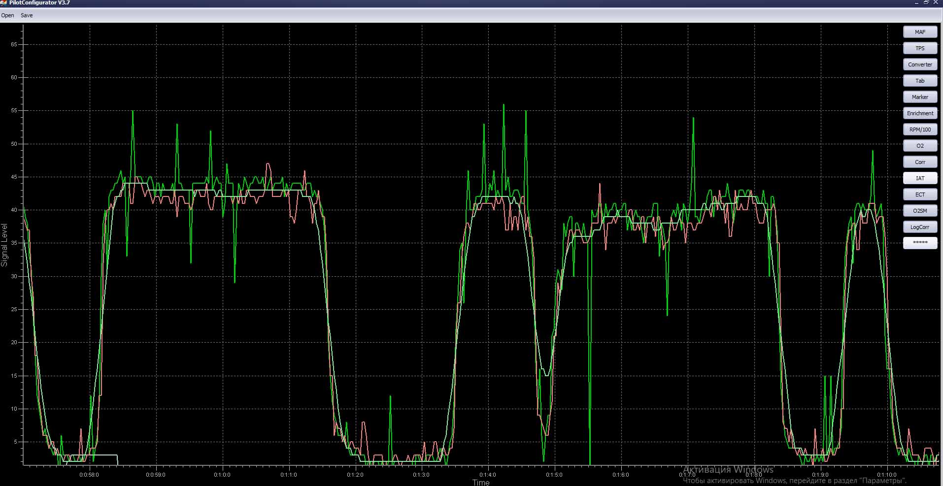

Let me know from which point did you take supply ground of the converter?
Also please check ignition system totally - high voltage wires with a multimeter and set spark plug's gap to 0.85-0.9mm .
Also check ground wire from chassis to engine/gearbox. And let me know how much wires goes from oxygen sensor - 1, 2, 3 or 4.

In msg#6 Log is very strange( a lot of spikes of the converter output) and i dont see a table, which was used when this log was making.
I think there culd be issues with a ground or with an ignition system.
