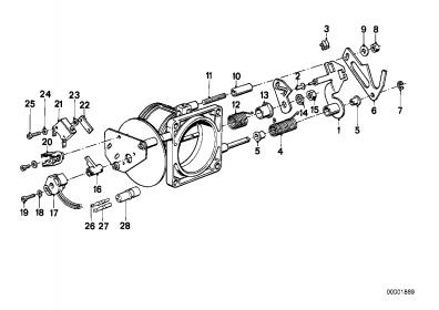

Have attached an illustration of the throttle body with the TPS setup.
17 is the TPS, 16 is the actuating arm and 22 is the idle position switch. 22 mounts at the two slotted holes on the mounting plate, on the inside of the plate. The TPS mounts on the outside of the plate. The actuating arm slides onto the throttle shaft on the inside side of the mounting plate and it protrudes through the mounting plate, piloting into the TPS. The two slots on the end of the bore of the actuating arm engage the two teeth in the TPS. The throttle shaft has a machined flat that engages a flat in the bore of the actuating arm. The actuating arm also operates the idle position switch.
The mounting bolt bolt pattern for the TPS is the same as early Ford and GM two-bolt mounting of the TPS.
Voltages........
Vref 5.0V
Vmin 0.7V
Vmax 4.77V
BMW note in their troubleshooting sheets that Vmax must be at least 0.22V below Vref.
Also, Vmax is used to caculate, via the auto trans ECU, wide open throttle position for the DME!

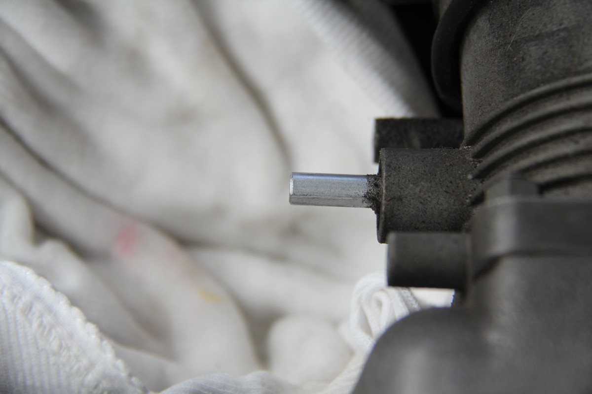

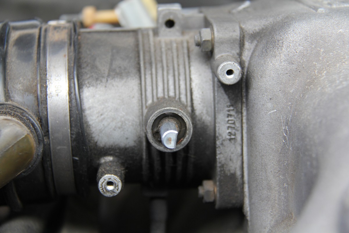

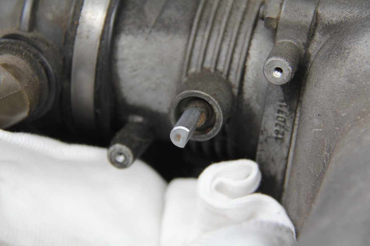

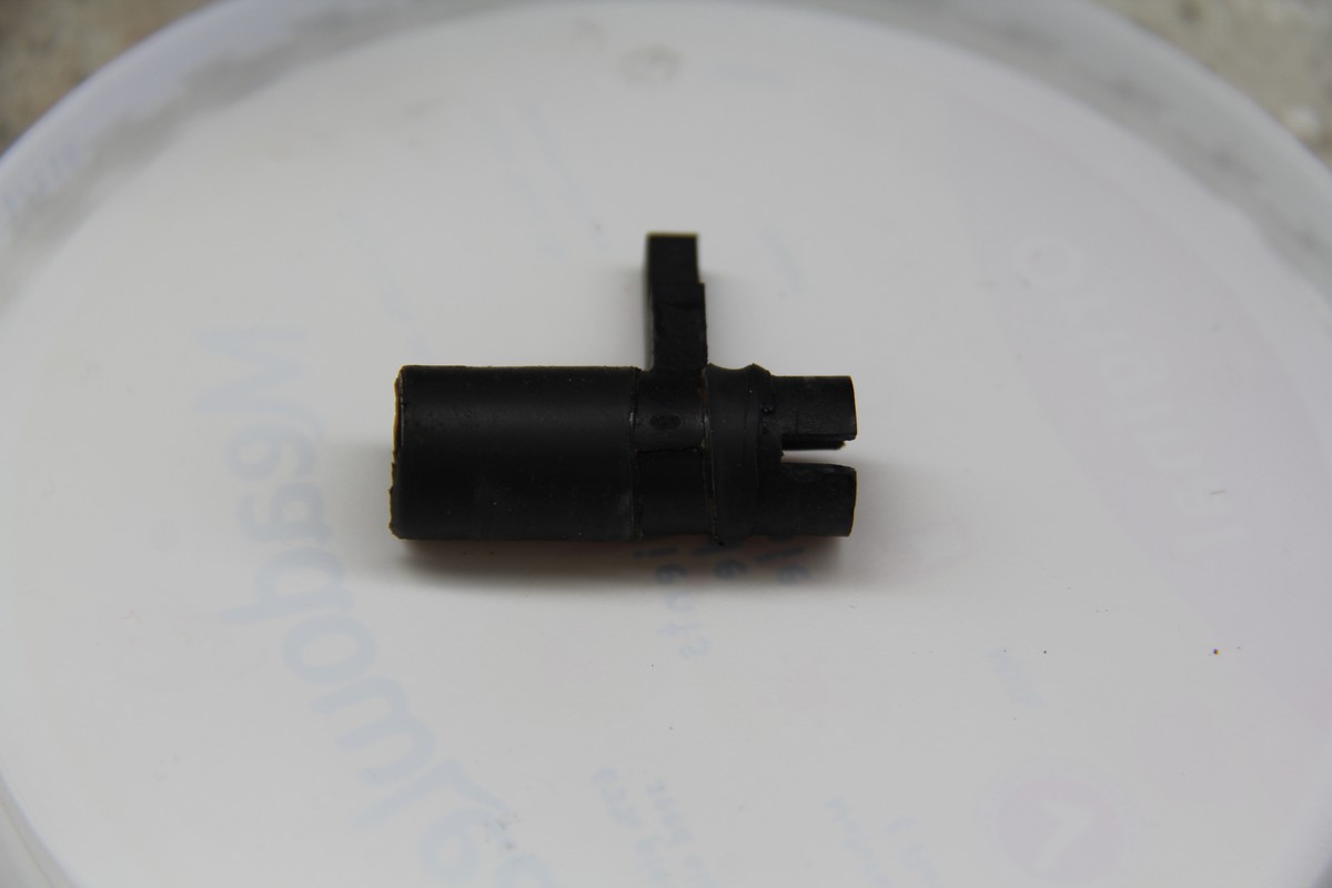

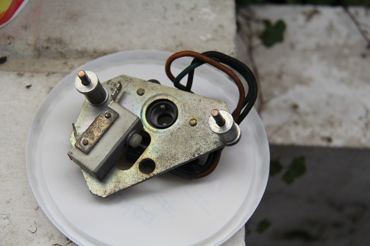

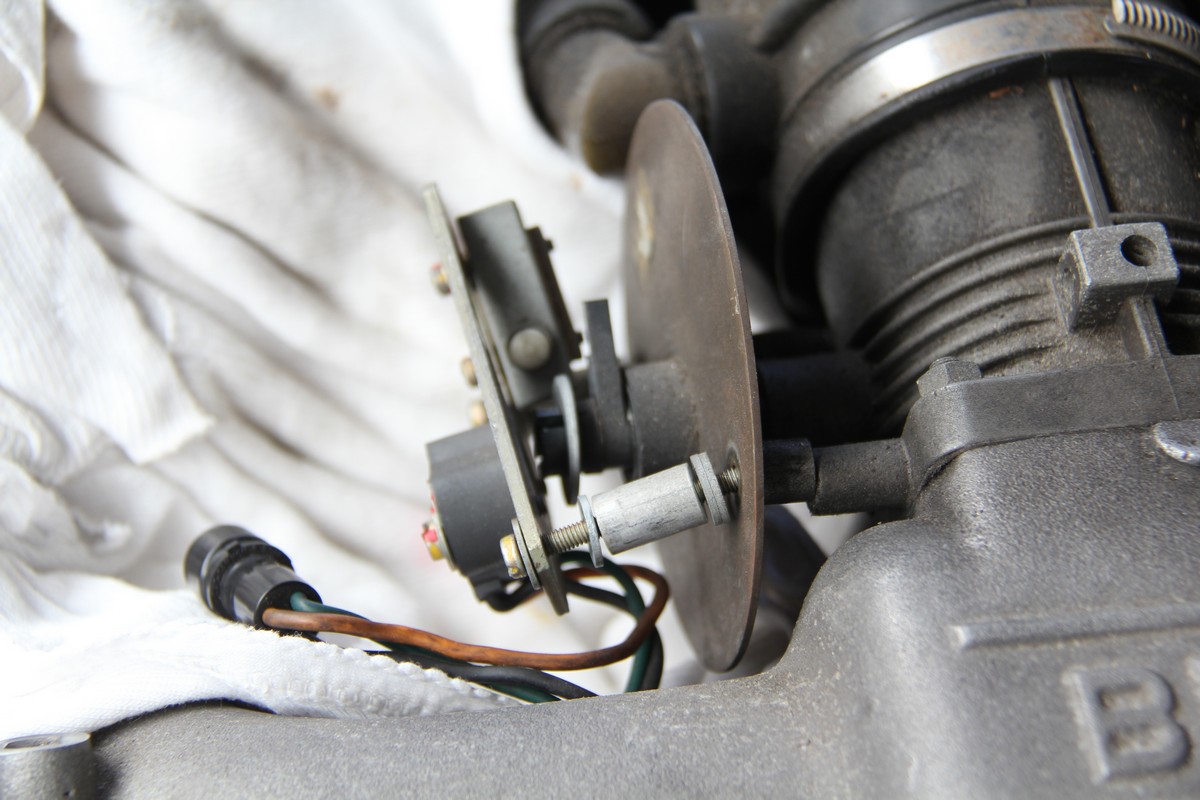

Attached are the photos from the disassembly of the TPS/idle switch assembly.
Besides the actual TPS's carbon tracks wearing out, another issue is the actuating arm. When you zoom in on the photo of the arm, you can see where it has split and I have repaired it with weatherproof heat shrink.
Once the TPS assembly is removed, it appears that the throttle body casting is likely the same as is used for manual transmissions as it looks like the mounting pylons are spaced about the same as is needed to mount the regular style throttle switch.
Measurements of the mountings and shaft of the throttle body......
Throttle shaft dia is 8mm.
Throttle shaft across the flat section is 6mm.
The throttle shaft extends 18.5mm from the TB housing.
When looking at the end of the throttle shaft, the throttle shaft rotates in a clockwise direction as the throttle is opened.
Spacing between the two mounting pylons is 70mm, this being from center to center of the mounting holes.
Mounting bolts are 4mm
I would like to be able to retain the large round plate as it is the mount for the weathershield boot that covers the TPS assembly. This simply makes it all look tidy.
