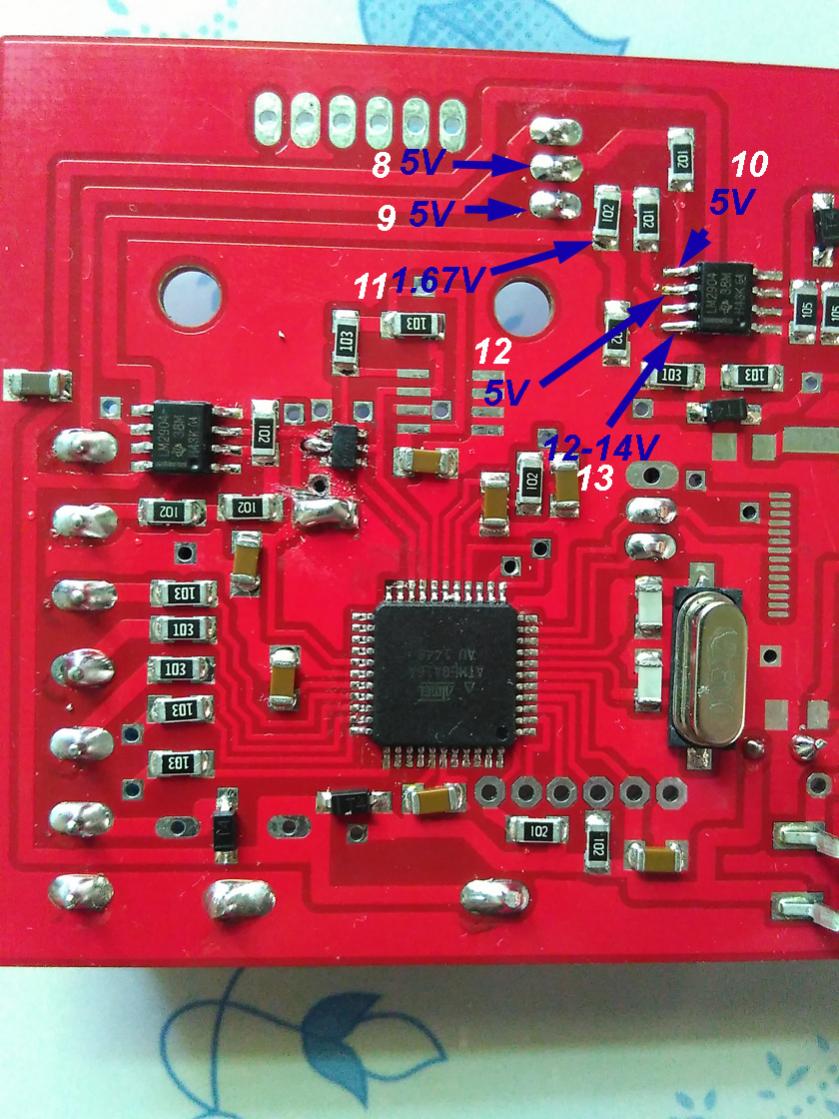

Is converter's output shutt off after firmware upgrade or before it?
Please check next voltages between ground and control points 1-7
with a same table test.tab
Let me know a result
Rgards

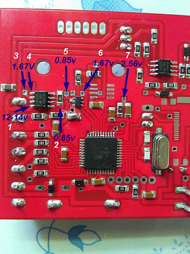

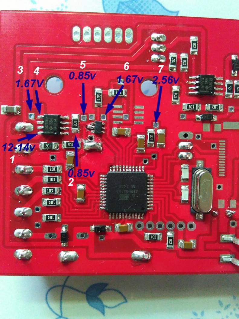

Старый 03.07.2016, 15:13   #20
Should I try firmware upgrade?
No.
And at point 1 11.9v but the car is not running so expected.
it is ok.
Now please check next points and let me know a results
