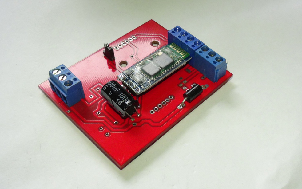

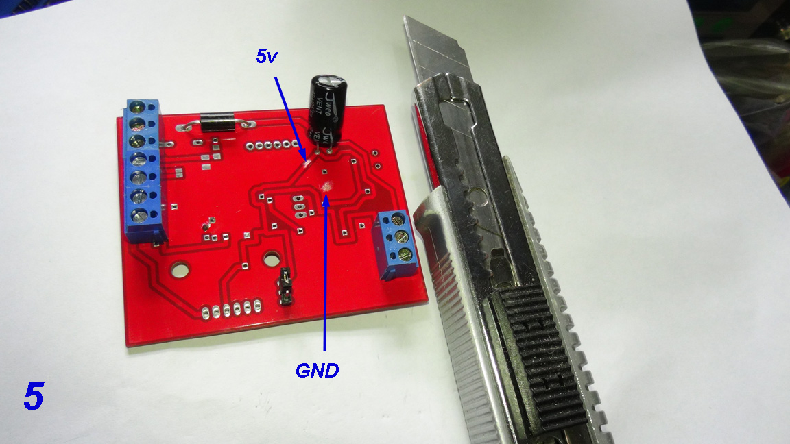

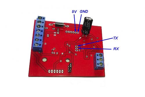

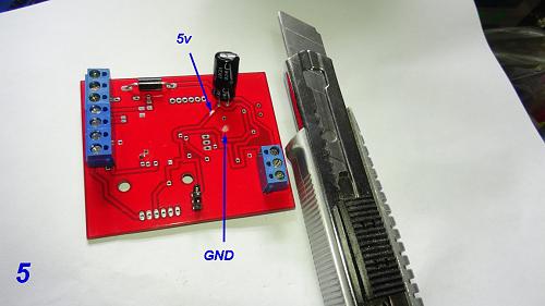

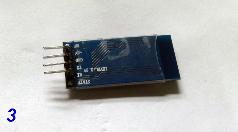

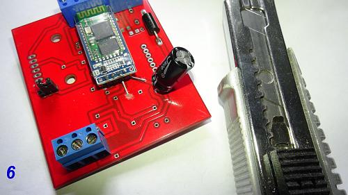

Старый 18.06.2016, 00:25   #6

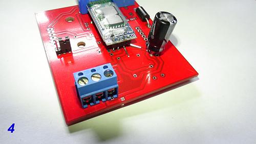

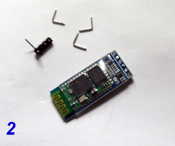

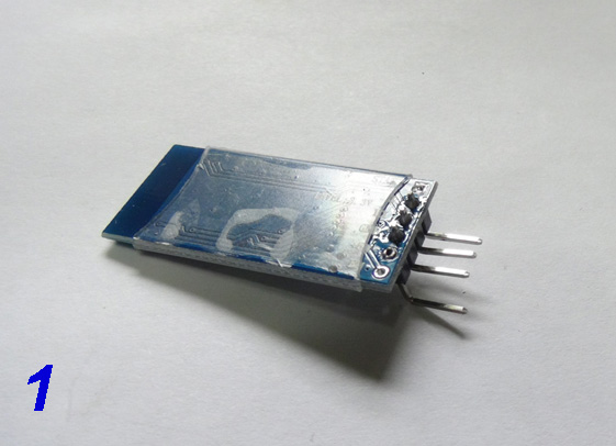

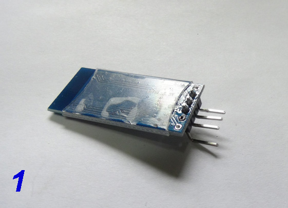

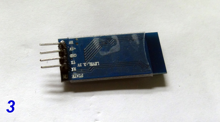

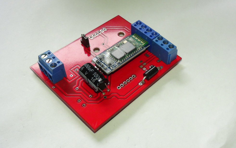

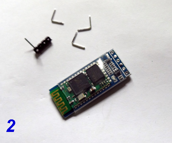

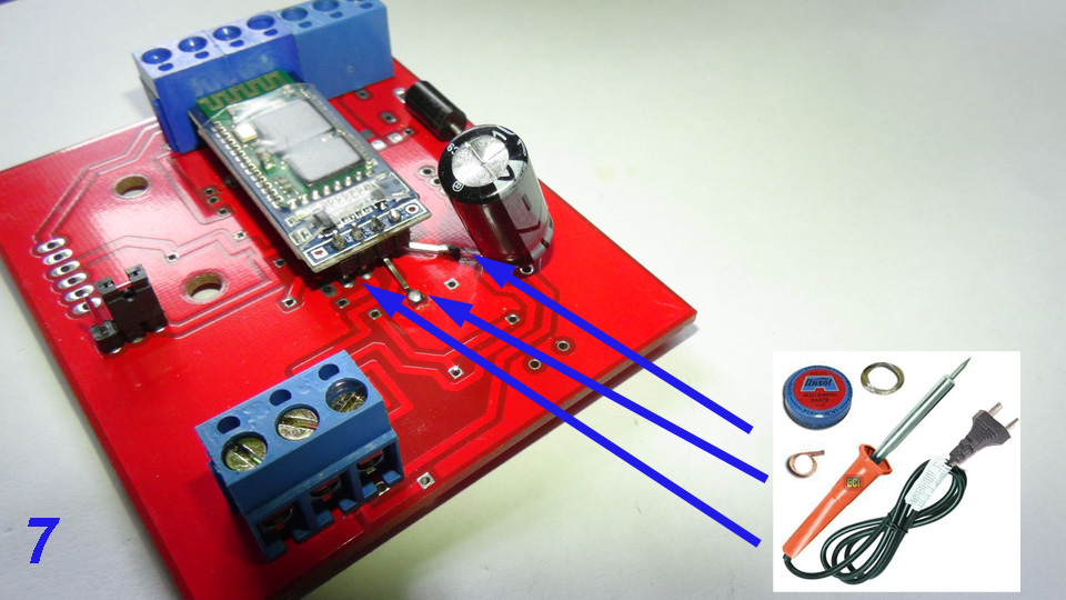

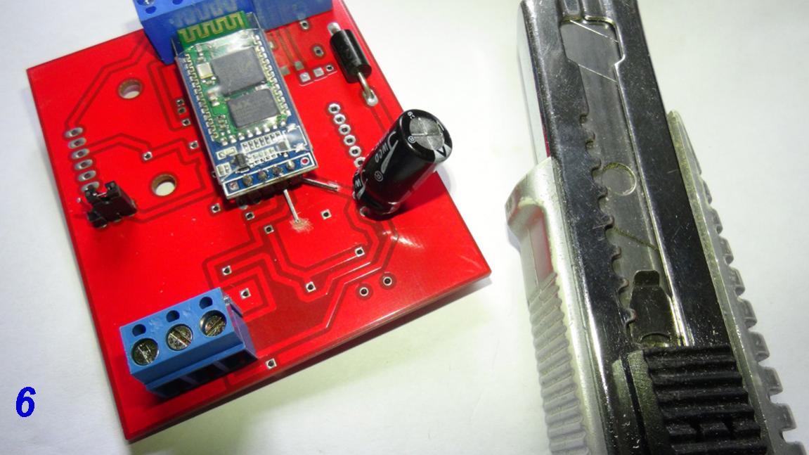

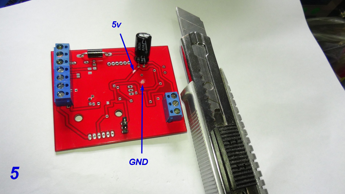

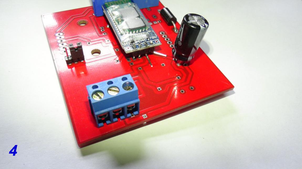

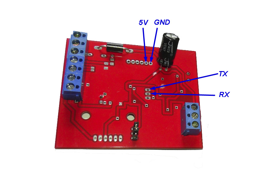

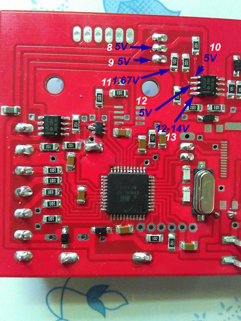

The most simple way is to solder HC-06 to the converter with a pieces of wires to the next points (this points are also marked at the bottom side of PCB HC-06)
A little bit harder way you can see at the next pictures ( you will need to remove connector of hc06 and solder it from bottom side etc.)

Старый 22.06.2016, 15:51   #7
Rohan
Регистрация: 13.02.2016
Сообщений: 20
Rohan на пути к лучшему
Hi Pin
Just thought I'd update, have Comms using the Hc-06. But every time I turn car off, I have to restart the tuning program.
The engine now idles well, but from your video I have found that I need a trumpet in my air filter box. To provide smooth air flow. How much distance in front of maf do I need the air intake to be linear?
Rohan вне форума   Ответить с цитированием

Hi Rohan
When you turn off ignition , converter and bluetooth also turns off, and windows lose bluetooth connection. That is why you need to restart or choose com port again.
We working on resolving this problem.
