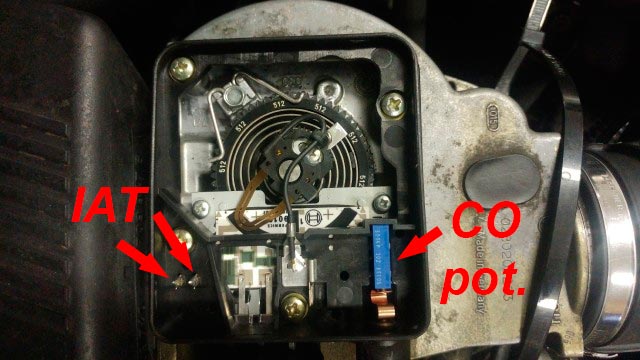

Hi.
To find pinout of VAF we typically remove it's plastic cover and watch directly on a board.
First we see the signal from the flap - you see there a slider and it is not difficult to find on what pin it goes.
Next you will see some wires from IAT sensor - one of them is signal - it goes directly on some pin of the VAF's connector. And other wire is connected in parrallel to some pin which is also connected to the ceramic resistive board - this is a GND( ground).
And the last available pin will be a 5 V reference voltage.
If it possible, please attach a photo of your VAF with removed plastic cover - so we can see a slider and a ceramic board - i'll try to show you on this pic.

Ok, i understand that, so other pins will don't connected?

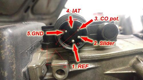

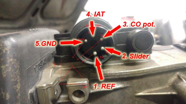

this is the vaf
and this is the connector, i wrote the resistence from slider to each pin
and the voltage on each pin
in other, on my HFM5 have temp sensor, i'll connect that direct to converter?

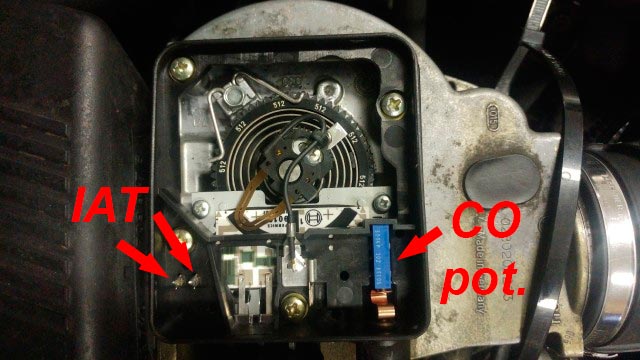

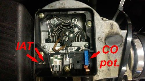

As i see your AFM has CO potentiometer too.
So you need to dissasemble AFM and measure CO potentiometer's resistance and setting, next you can place the same value and setting external potentiometer in a wiring.
Or you can remove it from AFM and install in wiring .
Also i marked IAT's pins - you can desolder and use it as IAT in new installation.

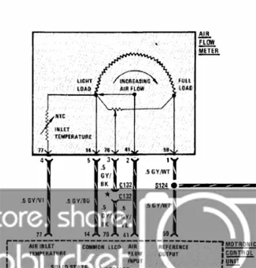

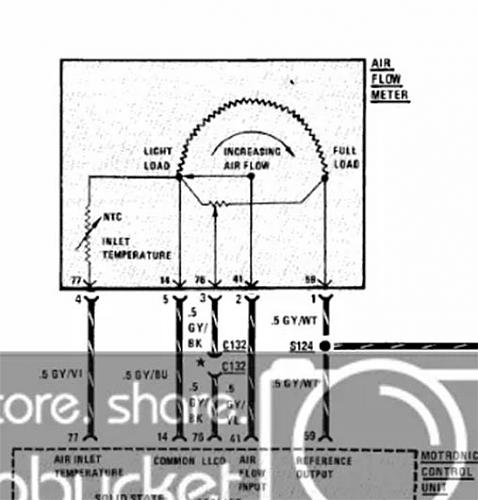

If i found the right schematic it seems that pinout should be like this
No, you shouldn't use it at all. Iat input of the converter is only for genuine iat sensor from genuine AFM if it will be installed and connected, otherwise you dont need to connect this input.
