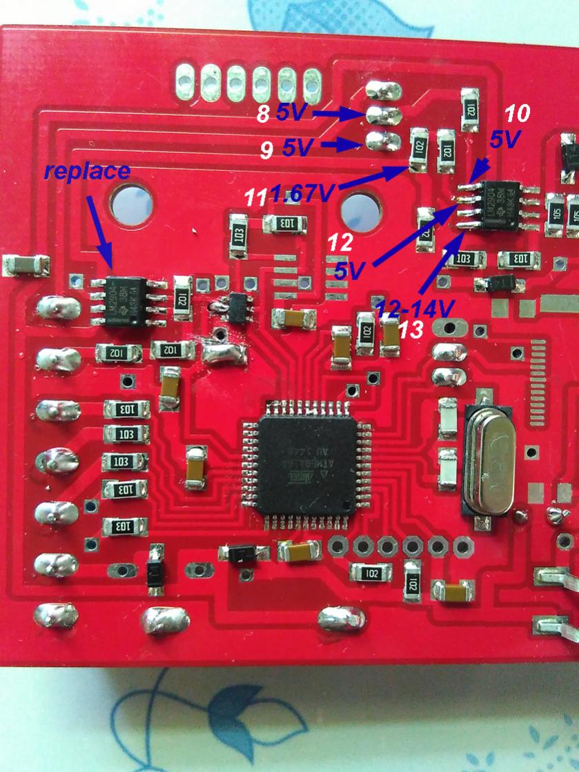

All good except 13 where I'm getting 11v

Hi Rohan.
Sorry, but it seems , that i didn't understood you in this message
You checked voltages on first picture and all of them ok except point 2 and point 7 am i right ?
If yes, then you need to replace left(near points 1,3,4) lm2904 ic
Regards

Hi Pin
First off, bugger how would this happen? Static?
Second there are a few different lm2904 's out there, which one?
I have the details from the top of chip but none that match this
Lm2904 38m h43k G4
Regards Rohan

Hello Rohan
The main function of ic 2904 is to protect other components from overvoltage and static. It works as buffer.
The reason of it's death in most cases is static, or wrong connection.
All over the production time we had only two reports from users with same problem.
In first case there were static, in second - high voltage discharge from bad ignition wire.
Regards
